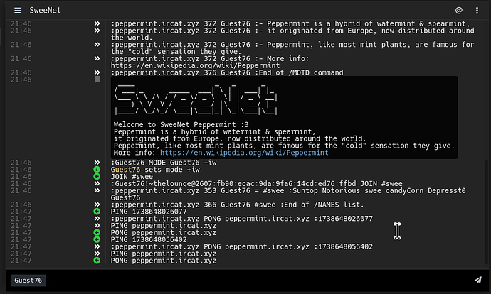

and SweeNet backlogs after that, and they stack up.
This might be an issue with TheLounge + ZNC, I haven’t tested it with plain thelounge (on web.ircat.xyz)
The webchat doesn’t seem to have this problem, it is probably not SweeNet’s fault (but maybe ZNC or The Lounge’s)
Should I enable raw logs on peppermint lounge itself?
but why would SweeNet be the only one getting

it might be the fact that SweeNet and the ZNC are connected to the same node, i will try connecting to Sugarcane instead of Peppermint.
Sugarcane doesn’t have IRCat installed yet, so you won’t be able to connect to it, I don’t know if it might be a problem with IRCat lacking IRCv3 features (ZNC has IRCv3 features while IRCat doesn’t have any).
Edit: This actually might be the problem, I’ll try implementing some IRCv3 features asap
I have implemented IRCv3 server-time on IRCat, Peppermint Lounge should be calm now (since that’s the only tag that Libera uses under PeppermintZNC)
